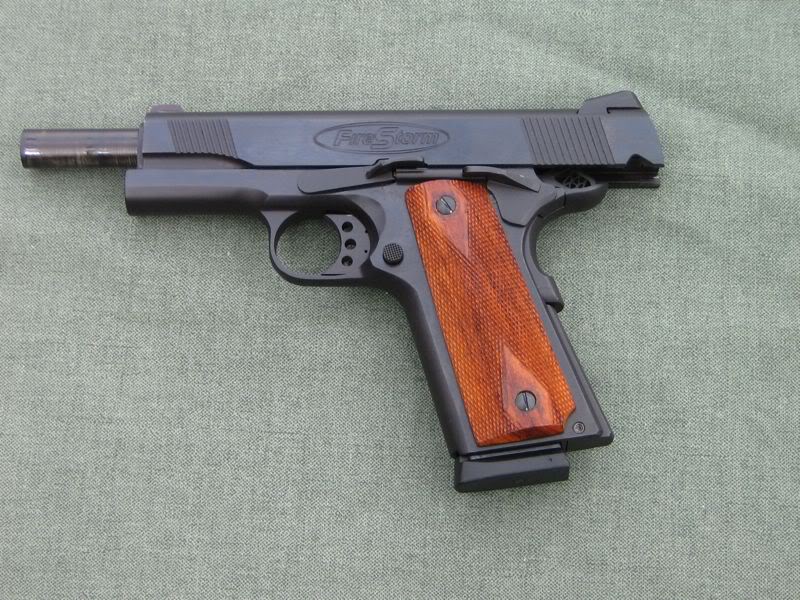

A nice feature of this particular pistol is the use of a standard barrel bushing, spring plug, and a standard guide rod. This allows the user to field strip the weapon in the time-honored tradition of the Model 1911. Since no full length guide rod is used, no special disassembly instructions will be necessary.
The Firestorm DLX Government Model is shown in slide lock.
