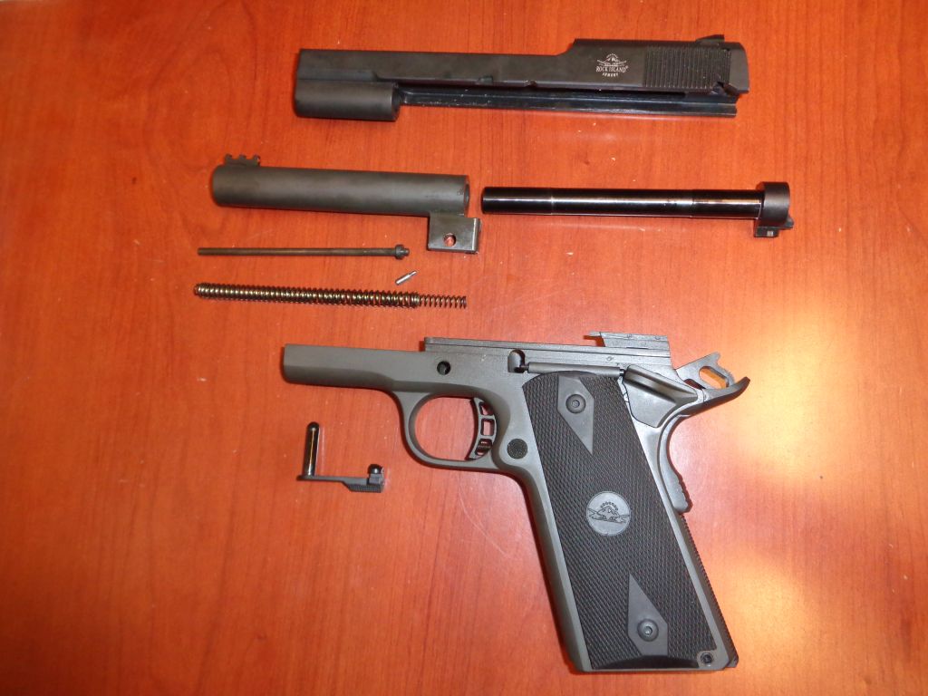

Take down proceeds almost nothing like a standard 1911. The first step, removing the slide stop, works the same (with one exception, which I'll discuss later). The slide and barrel are then removed from the receiver as a complete assembly. Once the slide assembly has been removed, all resemblance to a standard 1911 disappears. It’s a completely different animal. I would advise new owners to read the owner’s manual before disassembling the pistol, but … take it with a grain of salt.
Field stripped – slide assembly removed from receiver
The XT 22 Magnum has a full-length guide rod and a dual recoil spring assembly. The recoil spring plug is not removed – it remains in the side. The parts list shows it as a separate part, but it’s not loose. I suspect that it’s threaded into the barrel, but I didn’t attempt to remove it to verify this. The instructions on disassembly don’t call for removing the recoil spring plug, so I didn’t.
Perhaps it would be best to reproduce the manual’s instructions for disassembling the slide and barrel:

It all goes as described until the step calling for disengaging the recoil spring guide from the barrel lug. That’s not easy – the dual recoil springs are a lot stiffer than I expected, and the shoulder on the guide rod is too small to get a good grip on. Disengaging the guide rod from the barrel lug was difficult. But that wasn’t the end of the problem. Even disengaged from the barrel lug, the guide rod was too stiff to move laterally far enough to allow removing the barrel from the slide. Unlike any other 1911, because of the open top slide the XT 22 Magnum barrel removes out the top of the slide, not out the bottom. I found that I had to fight the guide rod to free up the barrel lug so the barrel assembly could be removed from the slide.
Disassembled
Once the barrel was out of the slide, I got a surprise. What I had thought was a floating chamber is actually a floating barrel. The large, bull barrel that we see when looking at the XT 22 Magnum is really a barrel shroud. The outside diameter of this shroud (which looks like a full-length bull barrel) is 11/16 of an inch. The actual barrel is a full-length barrel, including the chamber, that fits inside this shroud, or sleeve. The barrel itself has an outside diameter of 7/16 of an inch. When the pistol is fully assembled, rearward movement of the barrel relative to the shroud is limited by a small underlug on the barrel that fits into a corresponding recess machined into the frame bridge on the receiver. There is a tiny, spring-loaded plunger that fits into a hole bored in the barrel shroud that pushes the barrel and chamber back when the slide retracts out of battery. With the barrel assembly removed from the slide, the inner barrel can be easily removed from the shroud. (Care must be taken not to lose the plunger; it wants to pop out and get lost.)
Detail of the barrel and shroud. Barrel plunger is at lower left.
Having completed our inspection of the disassembled parts and taken photographs, it was time to put everything back together. Oh, my! That proved to be even more difficult than the disassembly. The first problem is that the two recoil springs (and, especially, the inner spring) are longer than the guide rod. Getting the guide rod back into the hole in the recoil spring plug was difficult enough. Then, with the recoil spring assembly installed, it was even more difficult to put the barrel assembly back into the slide. In the end, I resorted to a home brewed method not contemplated in the owners manual: I compressed the recoil spring assembly until about an inch of the guide rod protruded beyond the muzzle. I then clamped the guide rod with a small pair of Vise-Grip® pliers to hold the recoil assembly forward while I replaced the barrel assembly in the slide. Once the barrel was in place, I released the guide rod, allowing the recoil springs to extend. The last step was to reengage the tip of the recoil spring guide into the recess in the underlug of the barrel.
If I were the owner of an XT 22 Magnum, I would certainly invest in two small Vise-Grip® pliers, to manipulate the recoil assembly when disassembling and reassembling the pistol.

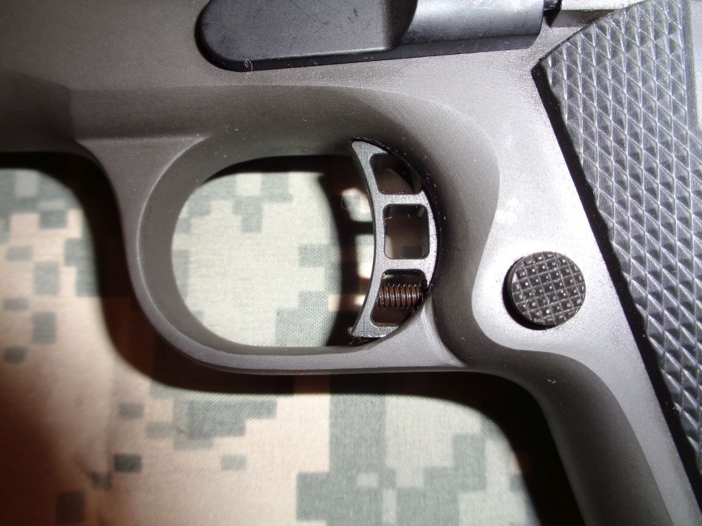

Moving from the slide assembly to the receiver, the details are a lot more conventional. The XT 22 Magnum has a lightened trigger with an over-travel adjustment screw; a standard 1911 teardrop-style thumb safety (single-sided, not bi-lateral); an elongated loop, Commander style hammer; a beavertail grip safety with a grooved palm swell; and what at first appeared to be a standard slide stop.
Trigger with over-travel adjustment

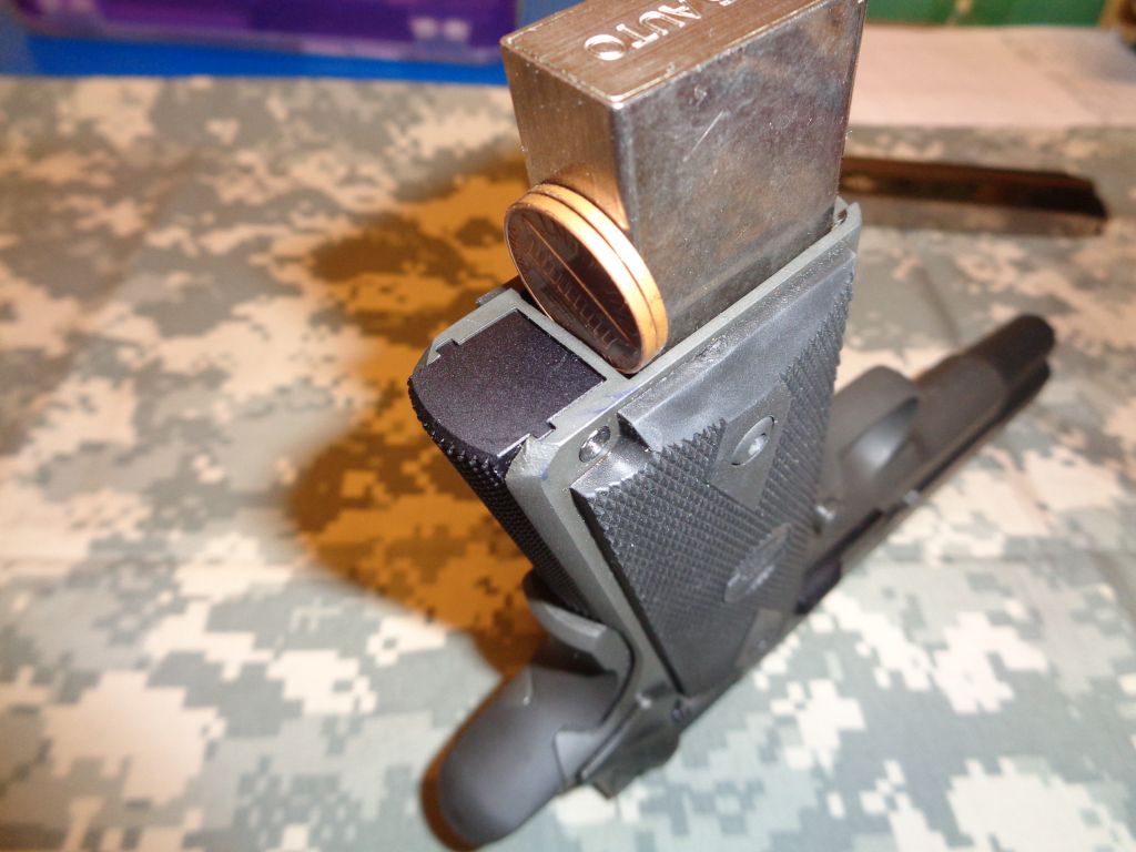

The reason why nobody has offered a 1911 chambered in .22 Magnum before this is simply that the .22 Magnum round is longer than the .45 ACP, and the .22 Magnum simply won’t fit in a standard 1911 magazine or receiver. In order to bring out the XT 22 Magnum, Armscor designed and manufactured a custom receiver that’s longer fore-to-aft through the magazine well portion of the receiver.
In order to quantify the dimensional differences, we took a tape measure and compared the XT 22 Magnum to a Remington R1 1911. The tale of the tape, based on our measurements, appears below. (At the end of this review, we’ll provide Rock Island’s specifications.)
Measurement Armscor RIA XT 22 Magnum Remington R1 1S Barrel Length 5.00” 5.00”Overall Length 8.5" 8.75”Height 5.13” 5.25”Grip Circumference 5.75” 5.5”Grip width (fore/aft) 2.25” 2.13”Sight Radius x.xx” 6.75”Capacity 15+1* 8+1
The magazines are the width of standard 1911 magazines. This means they have a slight taper at the top, resulting in a magazine that holds the cartridges in a staggered array in the lower magazine body. Like the receiver itself, the magazine well is longer fore-to-aft than that of a standard 1911. The difference is almost exactly the thickness of two pennies, as illustrated by inserting the magazine from the Remington R1 into the XT 22 Magnum to show the dimensional difference.
