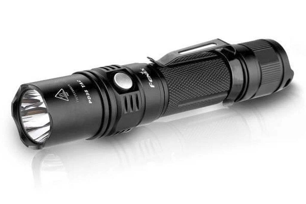

    The Fenix PD35 TAC
    The Fenix PD35 measures 5⅜ inches long and 1 inch in diameter at the lens bezel and at the tailcap. The forward edge of the bezel is slightly crenellated. A sealed, rubber pushbutton switch is set in the tailcap, protected by two surrounding “ears” (both of which are slotted to accept a lanyard, which is included in the package). To my surprise, the light pattern is not adjustable; turning the bezel less than an eighth of a turn out from the fully-inward position simply turns off the light. The majority of the light output is generally concentrated in the center of the beam, but there is a sort of halo of lower intensity light surrounding the bright center portion of the beam. Of course, with 1,000 lumens being sent downstream, what’s a little spill light? It might be argued that the halo is an advantage, providing better situational awareness in a tactical situation. (There’s that word again.)

    Then I fired up the Fenix PD35. All I can say is, “Holy sun spots, Batman!” I was completely unprepared for what I was going to see. The PD35 doesn’t focus down to a tight beam like the others to which I compared it. I initially considered that to be a drawback but, after seeing the PD35 at work on a dark night … maybe it doesn’t need a tightly focused beam. At a distance of 100 yards, the bright portion of the beam encompassed approximately 40 to fifty feet, and the surrounding spill light “halo” extended that to about 100 feet.
    Within the central part of the beam area, the light output at 100 yards was basically like daylight. I was stunned. In “turbo” mode, that little, hand-held flashlight was putting more light on the subject at 100 yards than my Jeep Cherokee with two high-output, halogen sealed beam headlights.
    Naturally, all that output comes at a price: heat. After just a minute or two of testing in turbo mode I could feel the forward end of the PD35 getting hot. That’s something I have never experienced with my lesser mini-flashlights or any of my the Maglites. Fenix is aware of this; turbo mode has a timer that limits use of the brightest setting to 5 minutes. I don’t think I would want to use it for even that long. There’s plenty of light available at one or even two steps below turbo mode, so I consider turbo mode to be something that’s not regularly used, but nice to have available when you really want to light up the night.
    The Fenix PD35 provides an astonishing amount of light in a small, handy package. With a sturdy, anodized aluminum body the unit appears to be well-made and durable, although this was not a long-term test so we didn’t evaluate it under real life use conditions. With the number of different operating modes available, the PD35 also offers a lot of flexibility.
