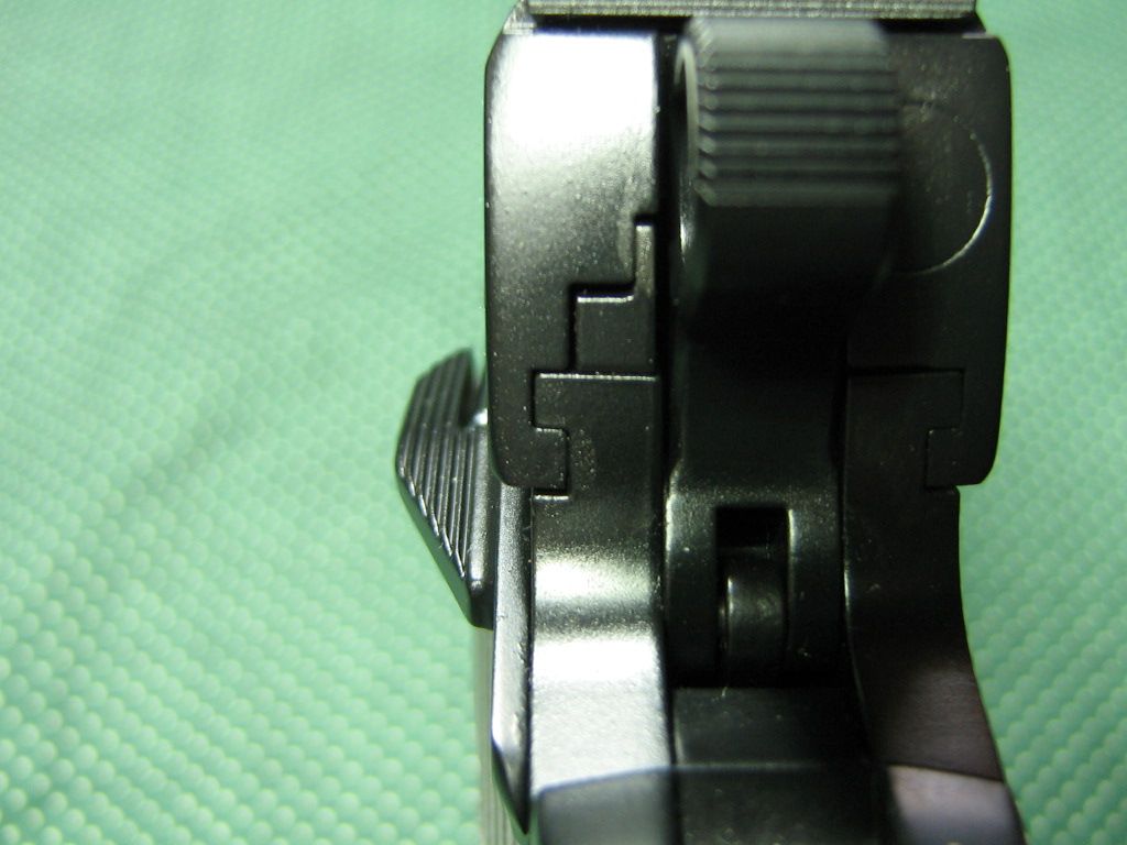

A photograph of the rear portion of the Volkmann Combat Custom shows the oval hammer, slim-shelf thumb safety, and beavertail grip safety. The grip safety is standard with a “speed bump”, and no problems were encountered with disengagement of this safety device during extended “combat shooting” exercises.
