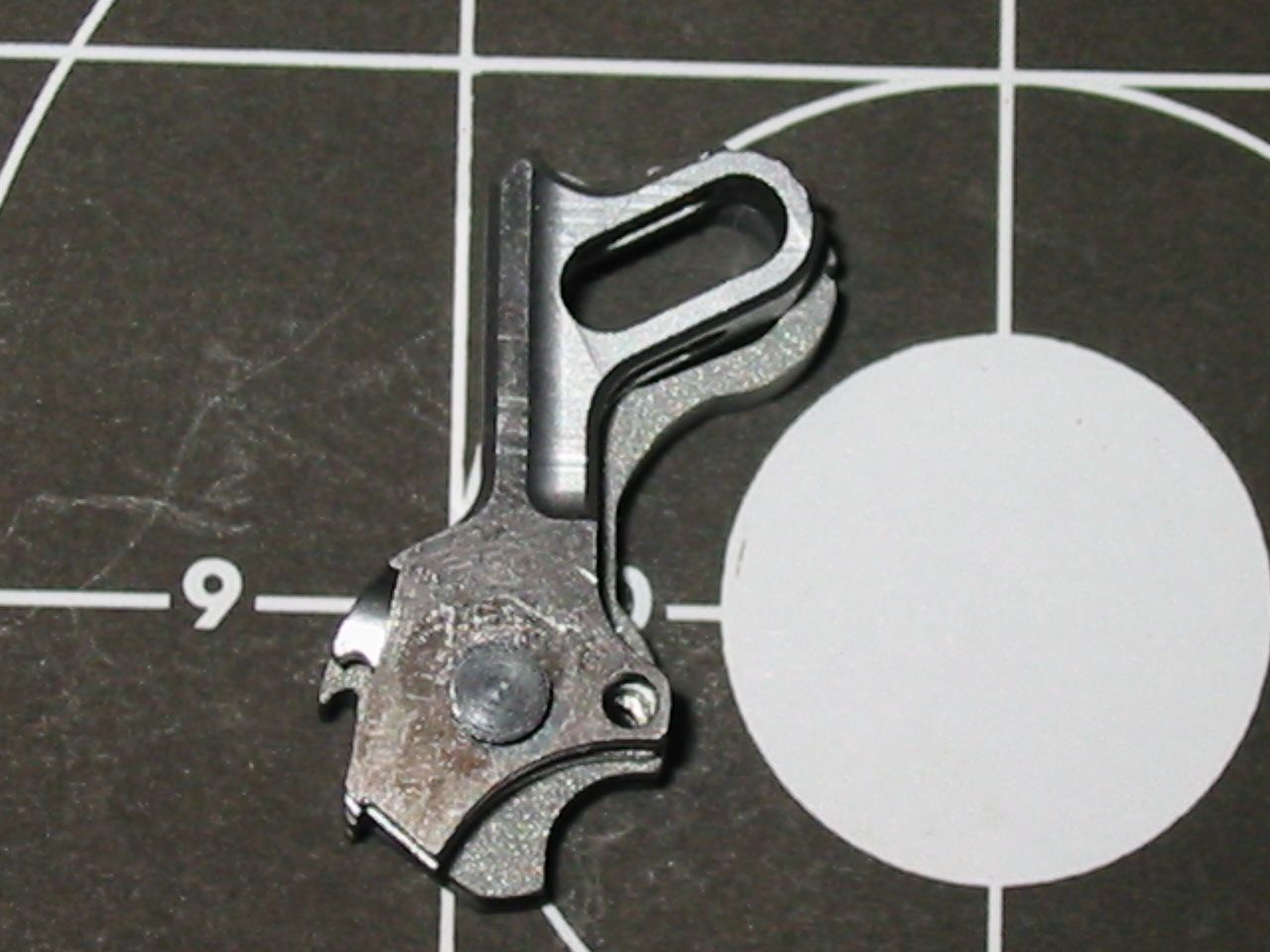

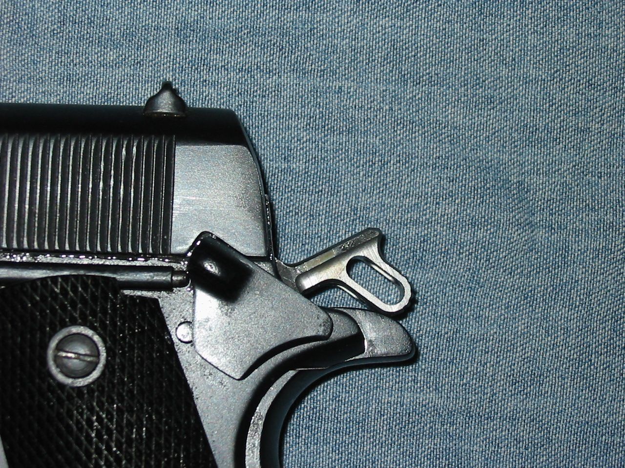

    At this point, those who have been paying attention may be saying, "Wait a minute! This is an elongated loop hammer, and those don't work with the GI grip safety. What's going on here?"

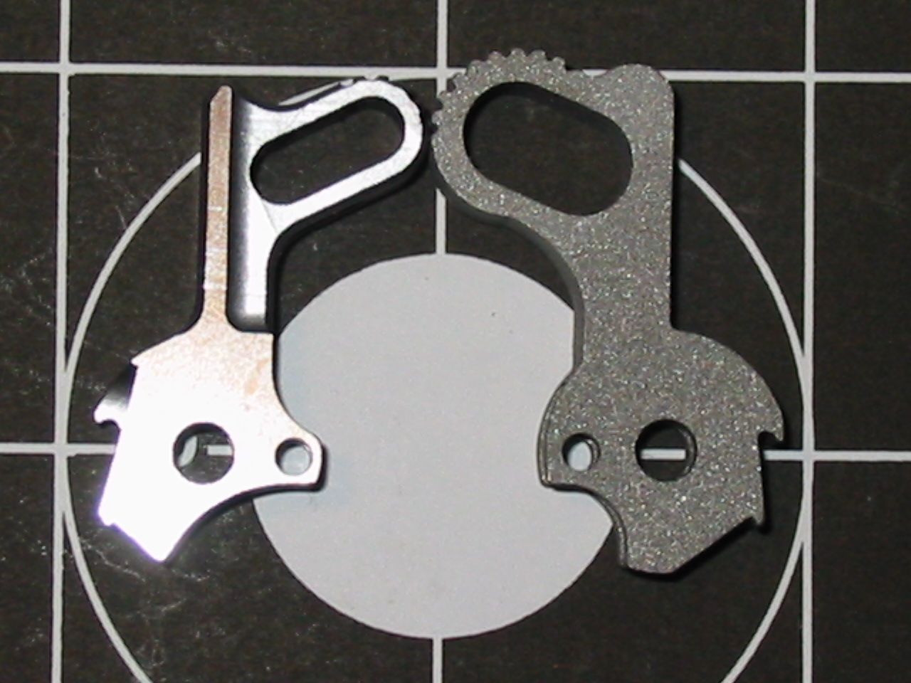

    What's going on is that it is, indeed, an elongated loop style hammer, but the loop is smaller than the typical version. Most elongated loop ("combat" style) hammers have the exact same outer profile as the original Colt Commander "rowel" style hammer, but with the hole enlarged and elongated. Those, indeed, will not work with a GI grip safety. They need a bite carved out of the upper surface in order to allow the hammer to be cocked, as shown in this photo of a 1991 Combat Commander:
    Compare that to this view of the EGW hammer cocked over a GI grip safety:

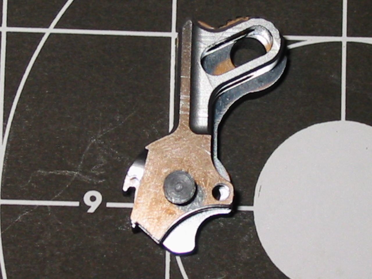

    The following two photos show the EGW hammer overlaid on a standard Commander "rowel" style hammer, and then a standard, elongated loop hammer. Note how the EGW hammer's loop is both narrower and shorter than the traditional hammers:
    Finally, the following photo is a direct, side-by-side comparison of the EGW hammer against a standard, elongated loop hammer:
