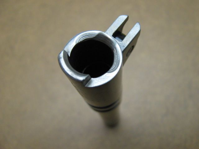

    Coltís National Match barrel
    To the casual observer, one may think that Colt missed a clean up step upon finishing their machine work around the barrel ramp, maybe so, but I can say that this in no way hinders the function and reliability of the gun.

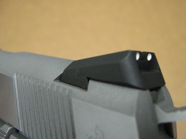

    Novak white 3-Dot low mount sights, dovetailed in front and rear, with the front sight not matching the radius of the slide top

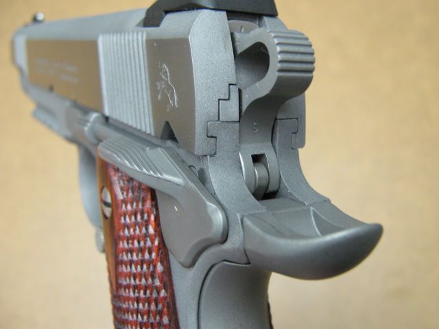

    A tight slide to frame fit, extended ambidextrous safety, fitted Smith & Alexander upswept beavertail with palm swell

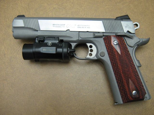

    Of course, the integrated light rail

    The low-mount Novak sights, with the front being dovetailed, are a nice touch, but the option for night sights and a wide notch rear model would be welcome upgrades.

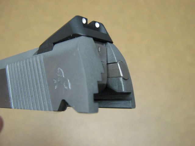

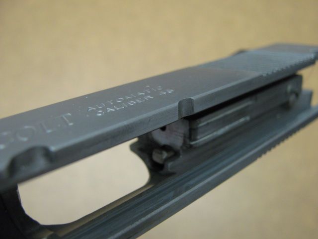

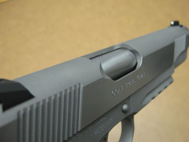

    Warning! Sharp areas ahead! Iíve had numerous people mention this about Colt over the years, and this model will not disappoint in this area. I donít care for some of the ďbevel carryĒ or ďmeltedĒ treatments that some makers put on 1911ís these days, as some of it is so over done that it takes away from the classic lines of the 1911. But a little taking off of some of the edges would go a long way to putting the bandage people out of biz.
    Note to Colt, please ease the sharp edges a bit.
    The front edge of the slide

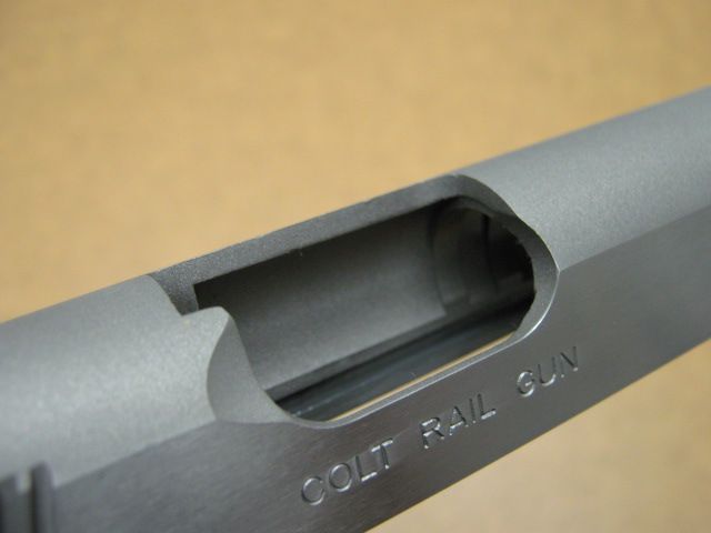

    The edges around the ejection port
    The vertical edges where the flats and the back of the slide meet
    Now it is interesting that Colt will put a slight bevel on the bottom edge of the slide:

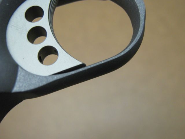

    Because of the sharp edge along the trigger guard, I have seen many a shooter tape the finger that goes up under the trigger guard when doing an extended shooting session where they are practicing draws and other manipulations.

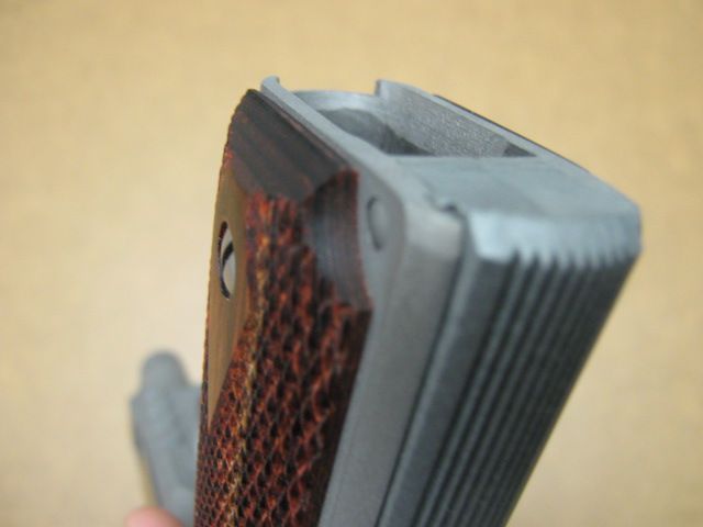

    The front points of the magazine well
    The edge where flats of the frame meet the bottom, around the magazine well area

    The Colt Rail Gun should easily fit into any duty holster that's made for a 1911 fitted with a rail/light combo. I personally fit it into the Safariland 6280 SLS model, using both a Streamlight TLR-1 and a Insight Procyon model lights.
