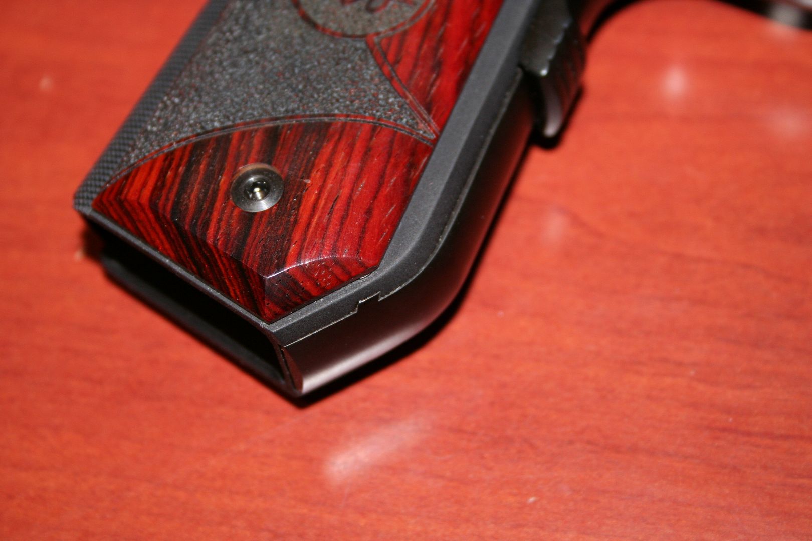

    I expected that the straight portion of the backstrap that remained above the chamfer would be too short and that the heel of my hand would be unsupported. That proved not to be the case. My hands are, as men’s hands go, fairly ordinary … neither huge nor tiny. I found that the Guardian nestled comfortably into a one-handed grip and that, contrary to my apprehensions, I did not feel that the heel of my hand was hanging off the pistol in outer space. I did notice, however, that although comfortable, the pistol sat in a one-handed hold at a slightly different angle (rotationally, as viewed from behind the pistol) than a 1911 with an unmodified grip frame. This in no way affected accuracy when shooting groups from a rest on the bench, but I felt that it did affect point of impact vs. point of aim when firing quick double and triple taps from a standing position.
    However, I hasten to point out that the difference between a straight MSH and an arched MSH affects point of impact by at least as much, which is why any 1911 that I might carry has a straight MSH, even if it arrived wearing an arched MSH. I confess to owning an old Colt Combat Commander and an Argentinean Sistema M1927 that still have their original, arched mainspring housings, but I have no intention of ever carrying those pistols and thus originality prevails over ergonomics, but only in those limited instances.

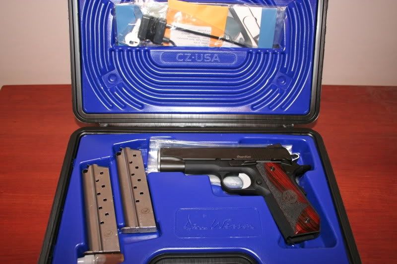

    The DW Guardian 9mm arrived in a blow molded plastic clamshell case, bearing the Dan Wesson name on the outside and a standard label identifying the contents as a Guardian 9mm Black Bobtail.
    Inside, we found the pistol itself, along with a fairly usual array of accessories, including two magazines, an owner’s manual, a cable lock, and a manila envelope containing a fired cartridge case (for those jurisdictions where such is required). The interior of the case is hard plastic, molded to the shape of the items that go in each recess.

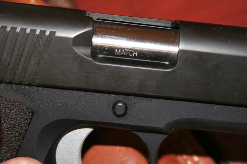

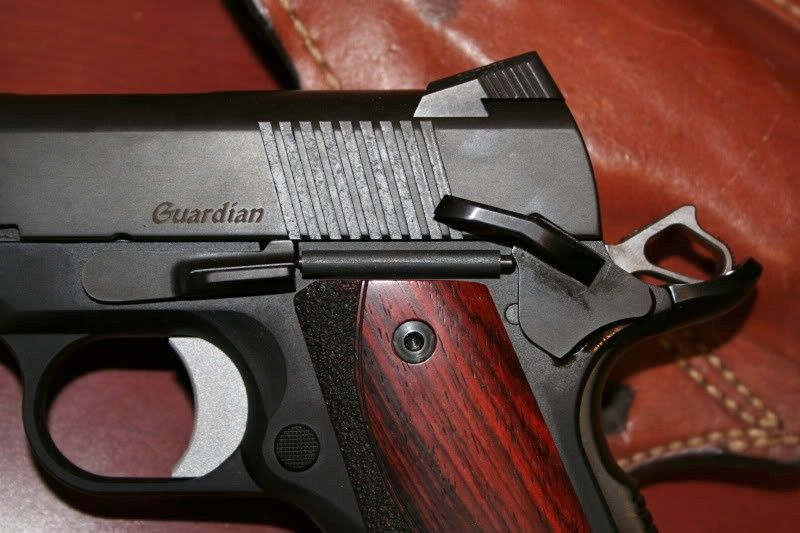

    The ejection port, of course, is lowered and flared. The photographs of the right side of the pistol make it appear that the slide stop pin is cut short with a flat tip that sits flush with the plane of the receiver, with the receiver slightly beveled. In fact, that's not what happens, but the slide stop pin is not exactly standard 1911, either. Most slide stop pins have the end rounded where the pin protrudes through the side of the frame. The Dan Wesson slide stop pin ends with a flat surface that has the outer perimeter beveled for insertion. It's a novel treatment that we haven't encountered before.
    The slide stop itself is not checkered in the traditional style but, although not an extended version, is of the simplified “shelf” design that seems to be gaining in popularity among 1911 manufacturers. The thumb safety, on the other hand, does have an extension to assist in operation as well as to provide a place to rest the right thumb for those shooters who utilize a parallel thumb grip. The thumb safety is not, however, an ambidextrous unit.
    The grip safety is a beavertail style with a “memory groove” type palm swell at the base, either an Ed Brown product or a clone of the Ed Brown unit. The beavertail is well fitted to the receiver.

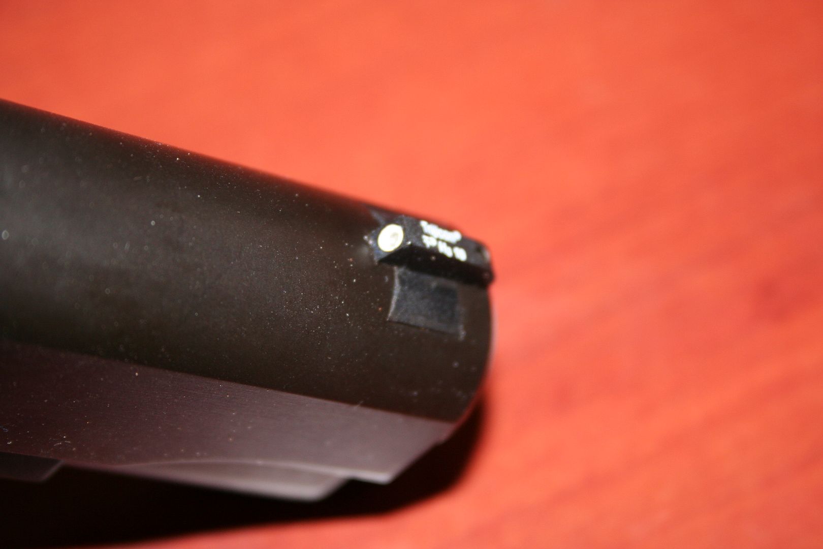

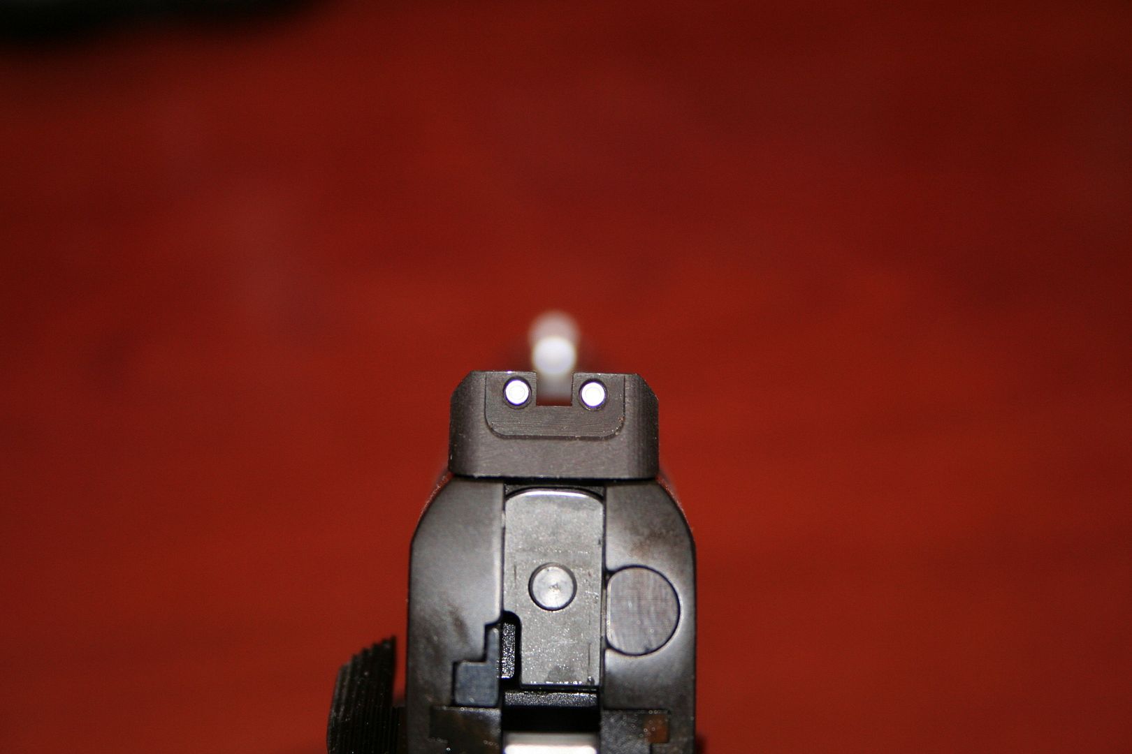

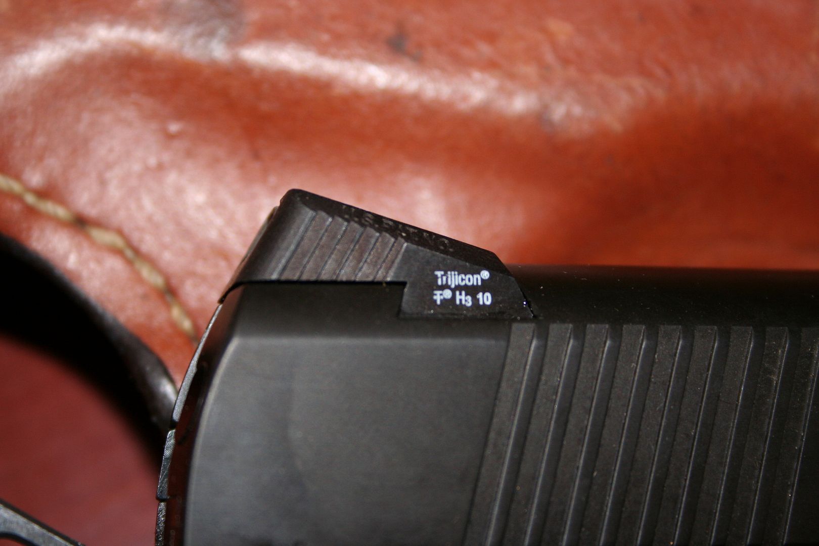

    The sights are Trijicon® brand night sights, with the rear being a low-profile wedge type and the front being set in a dovetail. The dovetailed front sight is nicely blended to the arch of the top of the slide.

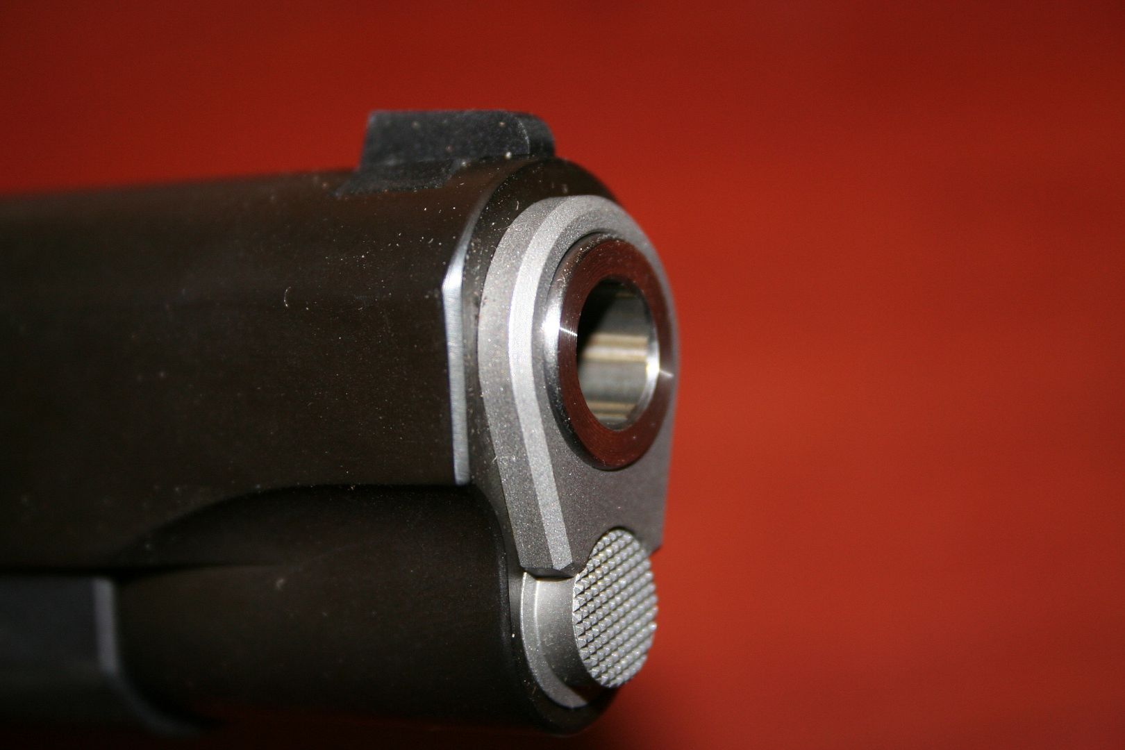

    The barrel bushing is a thick-flange type, which we have been informed (but have not verified) is sourced from EGW. The outer corner is treated with a carry bevel. The recoil spring plug is machined to mate properly with the thicker flange of the barrel bushing. The muzzle is finished essentially flat, with a slight bevel to the outer circumference and a slight crown at the bore. The muzzle, barrel bushing and recoil spring plug are left bright, to contrast with the matte black of the remainder of the pistol.

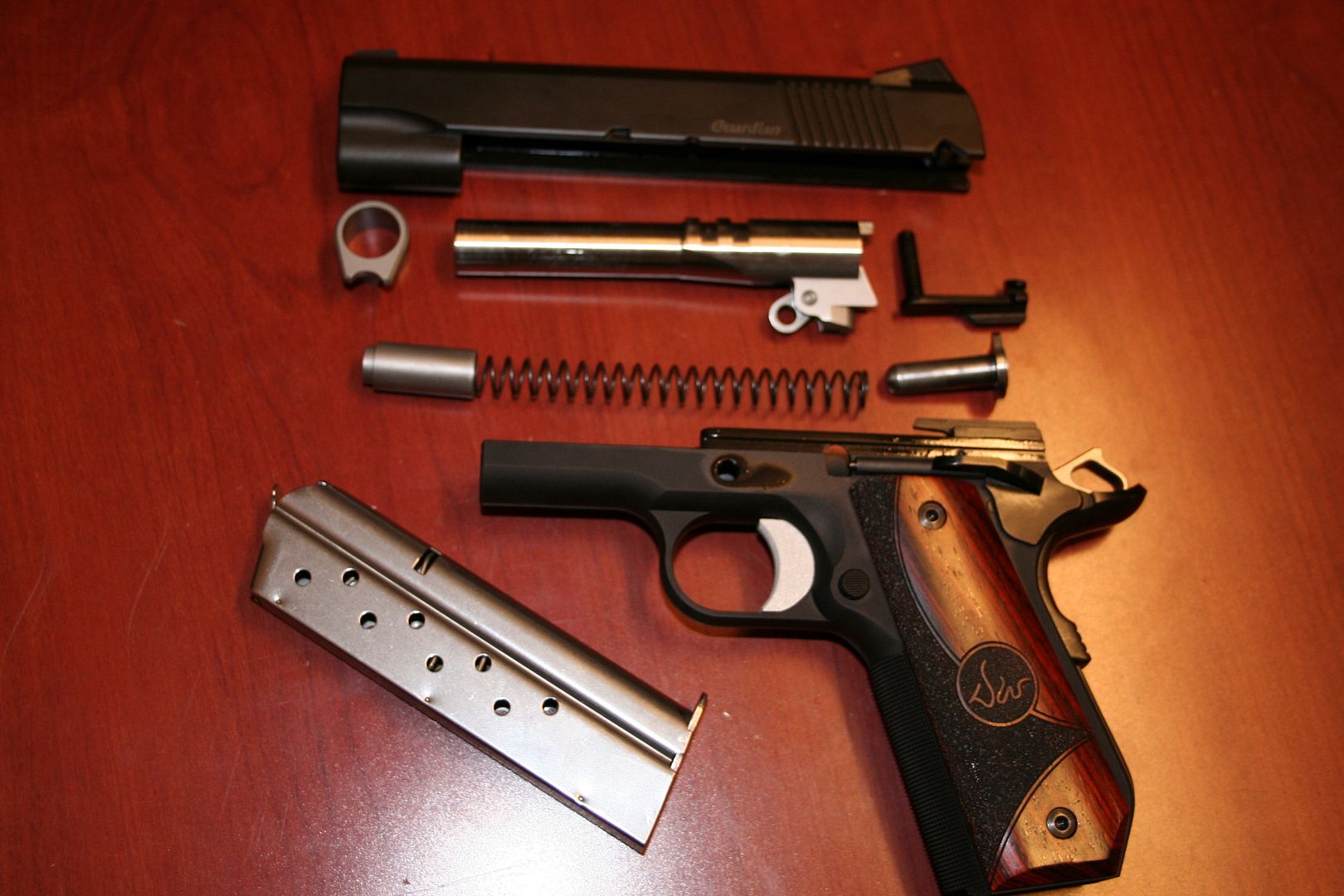

    Under the hood, the barrel uses an integral feed ramp, as is common especially with alloy frames and with 9mm pistols. The integral feed ramp both protects against the possibility of damage to a softer alloy ramp, as well as providing better case head support for the high pressure 9mm Parabellum cartridge.

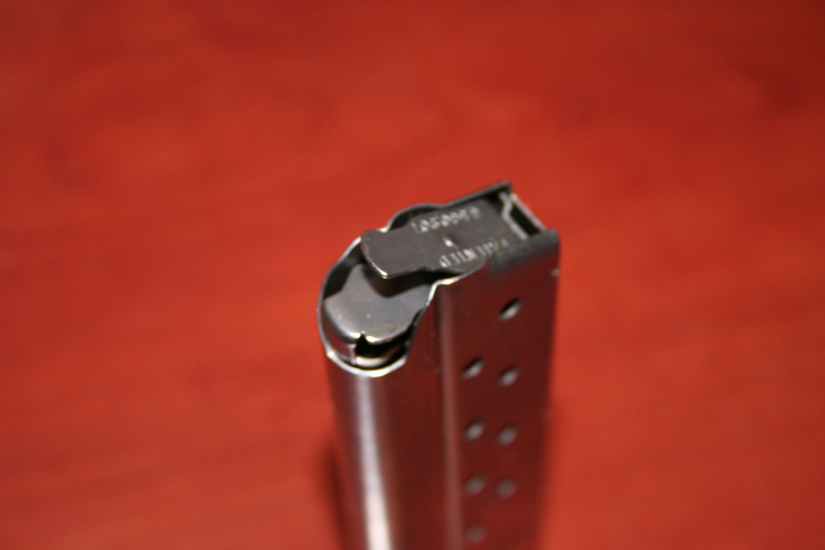

    The two supplied magazines are of Check-Mate manufacture and feature the proprietary Check-Mate patented skirted followers. The skirt at the front of the follower is intended to alleviate the tendency of the follower to tip forward at the top of its travel, which can cause the last round to nose dive into the ramp rather than feeding smoothly. From what we have seen comparing magazines with the Check-Mate follower to other types and brands of magazines … they work.

    Lastly, of course, is the signature bobtailed grip frame and mainspring housing.
