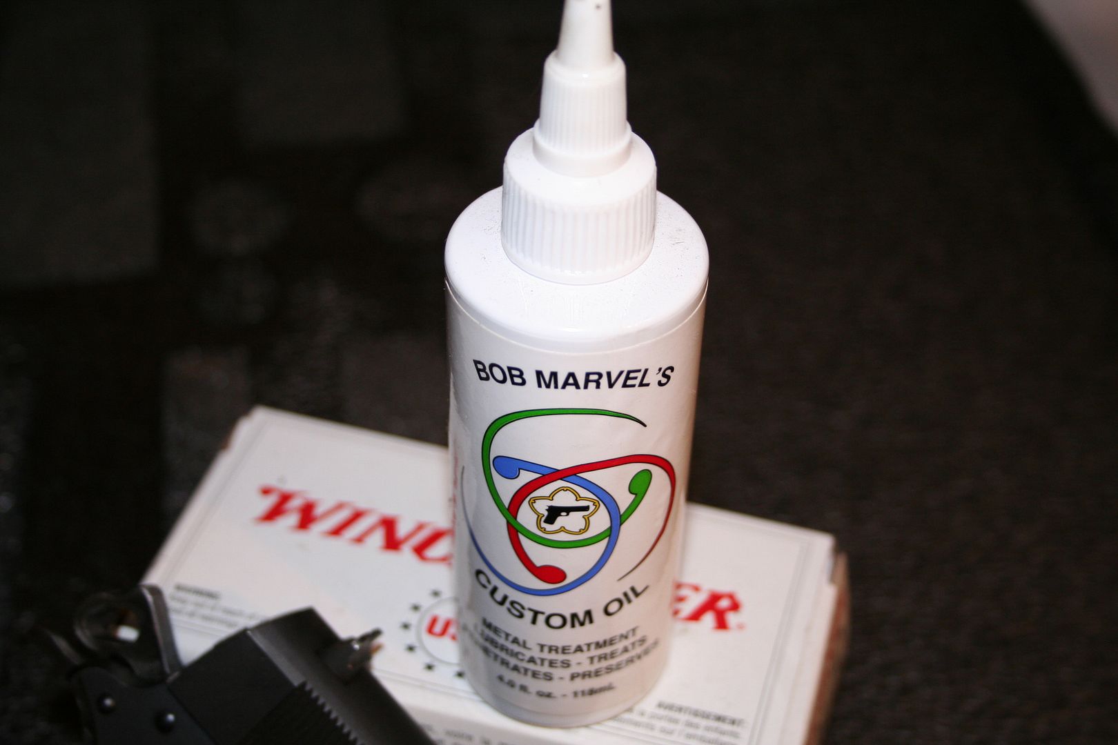

    Awhile ago the M1911 Pistols Organization received samples of a lubricant intended specifically for firearms, Bob Marvel’s Custom Oil. The samples were given to three of our gun test contributing editors: Frank Ettin, Steve Clark, and Harwood Loomis. This report is a compilation of their findings after working with Bob Marvel’s Custom Oil for a somewhat extended period.
    One point all three testers agreed on is that, given that the name on the bottle is “Marvel,” the oil should probably be called “Marvel Mystery Oil.” However, that name already belongs to another product, in the automotive market. Why do we say this product is a mystery? Well … because it works, and we don’t know why. The initial impression of all three testers was that the stuff has a viscosity pretty close to that of tap water on a hot day. Harwood, especially, was reluctant to even try it on a gun. But … anything to further the cause of scientific inquiry, so off we went. And, surprisingly, we found that Bob Marvel’s Custom Oil does work, not only as a cleaner (which is not a surprise for a product with such low viscosity) but also as a lubricant.

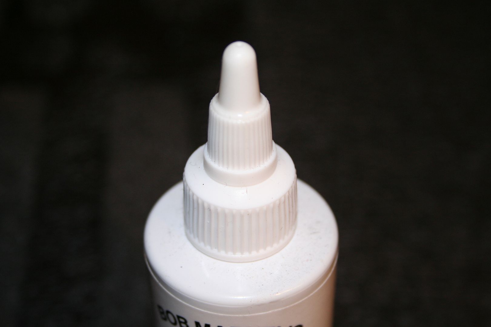

    The “turn-to-open, turn-to-close” applicator on the top of the bottle is nice for applying oil to the outside surface of a pistol, but less-than-ideal for application to small areas, like the frame rails and slide rails. For those areas, I use a cotton swab soaked in the oil. (I prefer needle applicators, like those found on some competing products.)

    According to Marvel's own web site, Bob Marvel's Custom Oil offer the following qualities:
    • Excellent treatment that lubricates, penetrates, cleans, & preserves metals
    • Proven performance for semi/full automatic guns, black powder barrels & suppressors
    • Better than graphite, PTFE or synthetics
    • Reduces friction & carbon build-up
    • Provides protective coating
    • No build-up or tackiness
    • Protects against corrosion
    • Repels moisture
    • Effective in high & low temperatures
    • Safe to use on polymer
    Our trials on 1911s confirmed these claims. Whatever makes up the chemical composition of this product, it appears to be well-suited for use on firearms and to live up to its claims.
