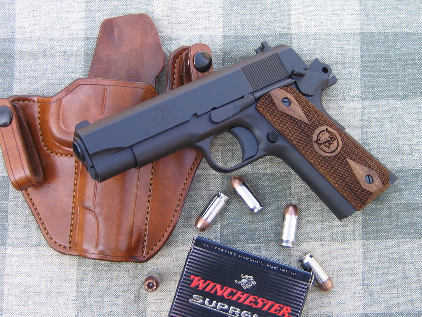

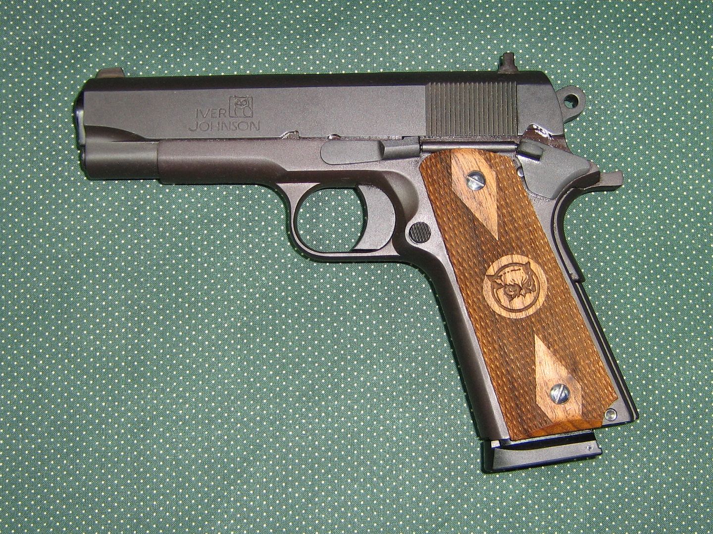

    The Iver Johnson Trojan is a 4.25 inch barreled 1911A1 chambered in .45 Auto. The pistol was housed in a black clamshell case, lined with gray egg-crate foam. Included in the case were the instruction manual and a key operated cable lock. The gun was wrapped in plastic, and literally swimming in oil. This fact was not lost on Todd Downing, who understands, as I do, that a trans-Pacific crossing in ocean-going cargo containers can be very hard on unprotected metal surfaces. More on that oil in a minute!

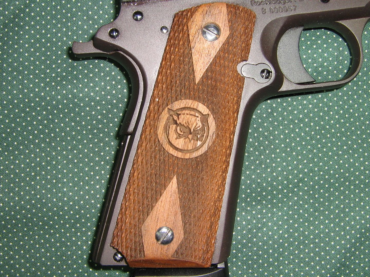

    The entire pistol (including the barrel and feed ramp) is finished in matte black, and is accented with double-diamond wood stocks with the Iver Johnson “owl head” logo in the center of each panel. The gun comes with one Mec-Gar 8 round magazine, which is equipped with a plastic extended base pad.

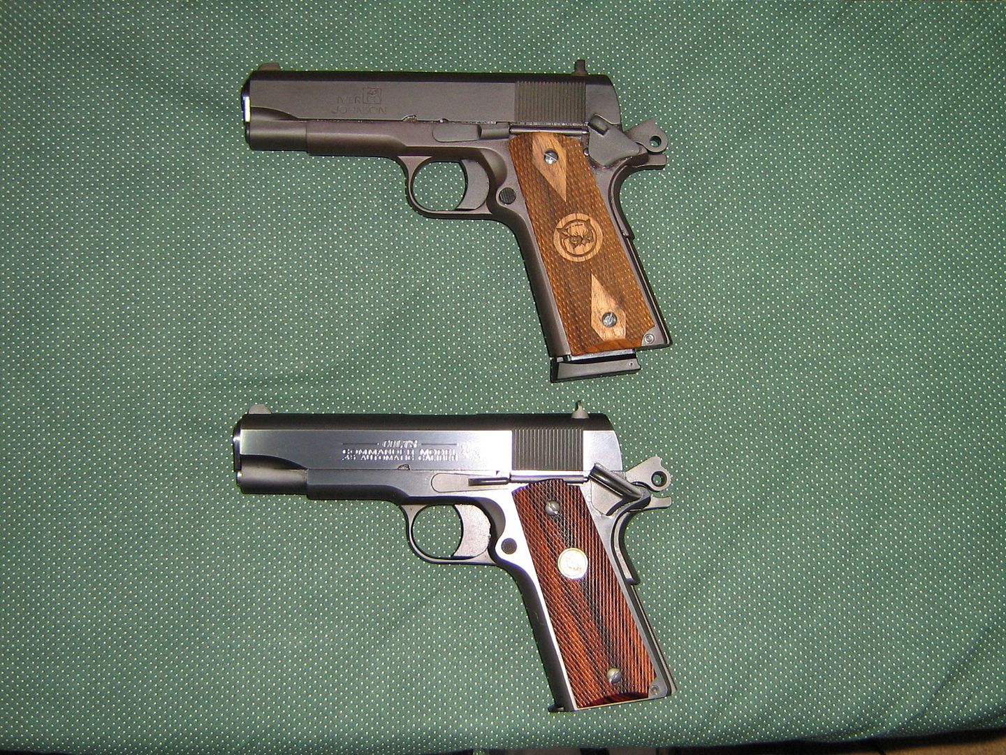

    The Iver Johnson Trojan appears, at first glance, to be a dead-ringer for my Colt Model 04691 Commander, so I detail-stripped the Trojan to find out. (I also needed to do this to remove all of the aforementioned oil.) Subtle differences include the ejection port, which is not lowered (as on the Colt) or flared, and some internal parts, which are metal injection molded on the Trojan. My personal experiences with weapons manufactured in the Philippines have shown me that the use of MIM parts is of no consequence in the reliability of those guns.
    This rather poor photograph shows the similarities between the Iver Johnson Trojan and the Colt Model 04691 Commander. Modifications to the Colt are a Wilson Bulletproof Slide Stop and a Wilson steel, checkered flat mainspring housing.

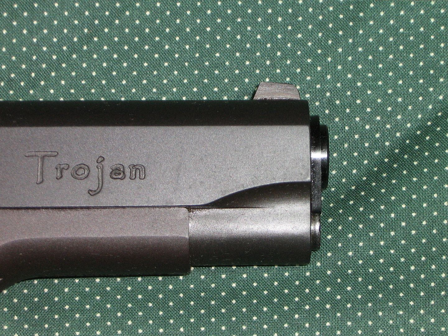

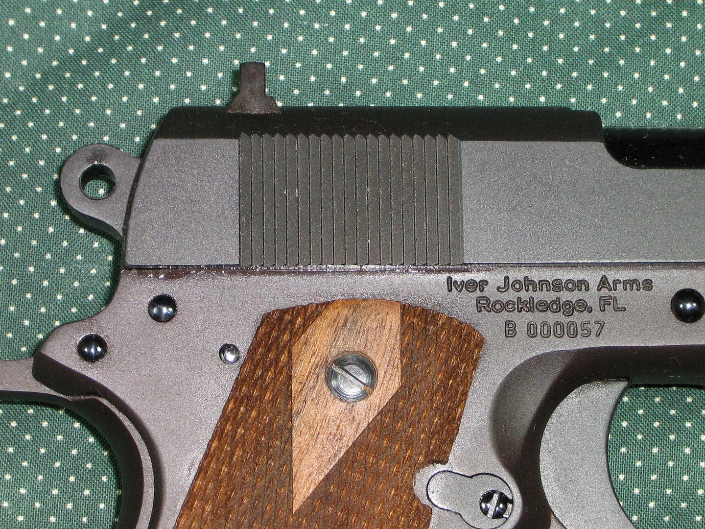

    The left forward side of the side has the “Iver Johnson” and “owl head” logo roll mark, while the front of the right side has “Trojan”. As with my Colt, there are 19 straight cocking serrations at the rear of both sides of the slide. The front of the slide is devoid of any cocking serrations. There is no firing pin safety on this pistol, nor (in my opinion) is one needed.
    Moving to the frame, a few more subtle departures from the Colt become apparent. The thumb safety is patterned after the original USGI thumb safeties. The slide stop is serrated, as is the magazine release. The front strap is smooth, as is the grip safety. One major difference between the as-issued Colt and the Iver Johnson Trojan is the use of steel in the serrated trigger and vertically serrated mainspring housing. In fact, every part of the Trojan will attract a magnet, except for the wooden stocks!
    The rowel hammer has a true half-cock notch, and the aforementioned thumb safety engaged and disengaged with a positive click. In fact, all of the controls were quite good on this gun, whether releasing the slide stop, or ejecting empty magazines.

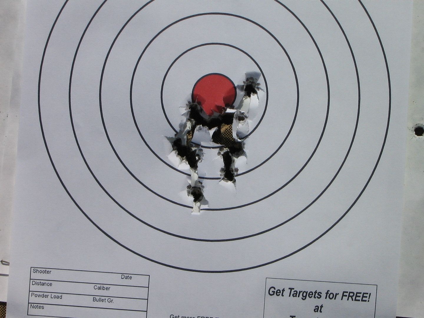

    This target shows 15 rounds of Armscor Remanufactured 230 gr. FMJ fired from a distance of 15 feet, off-hand. The bullet hole to the far right shows a round fired previously from a .357 Sig chambered Glock.

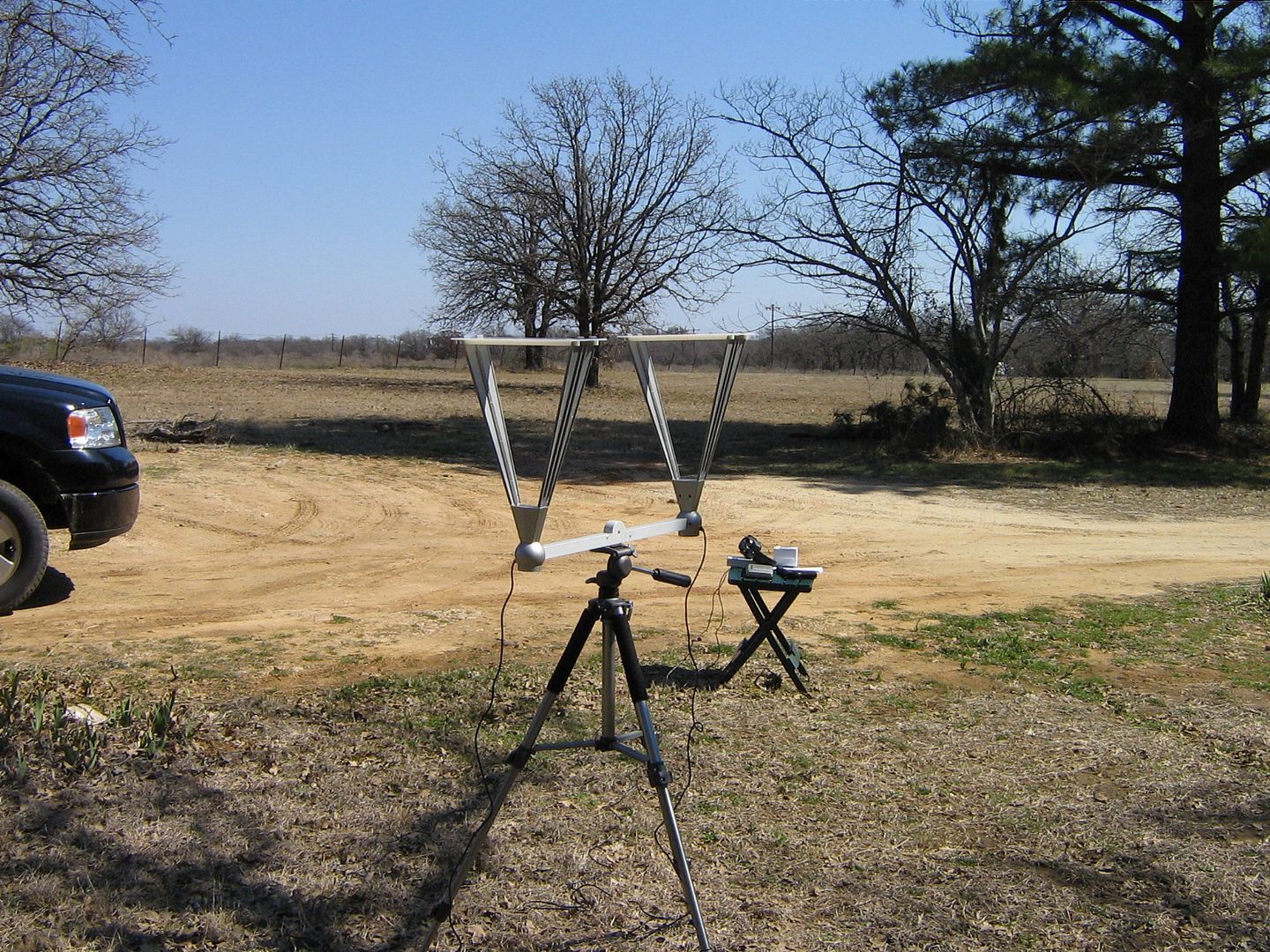

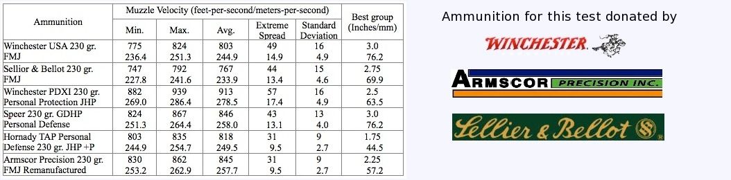

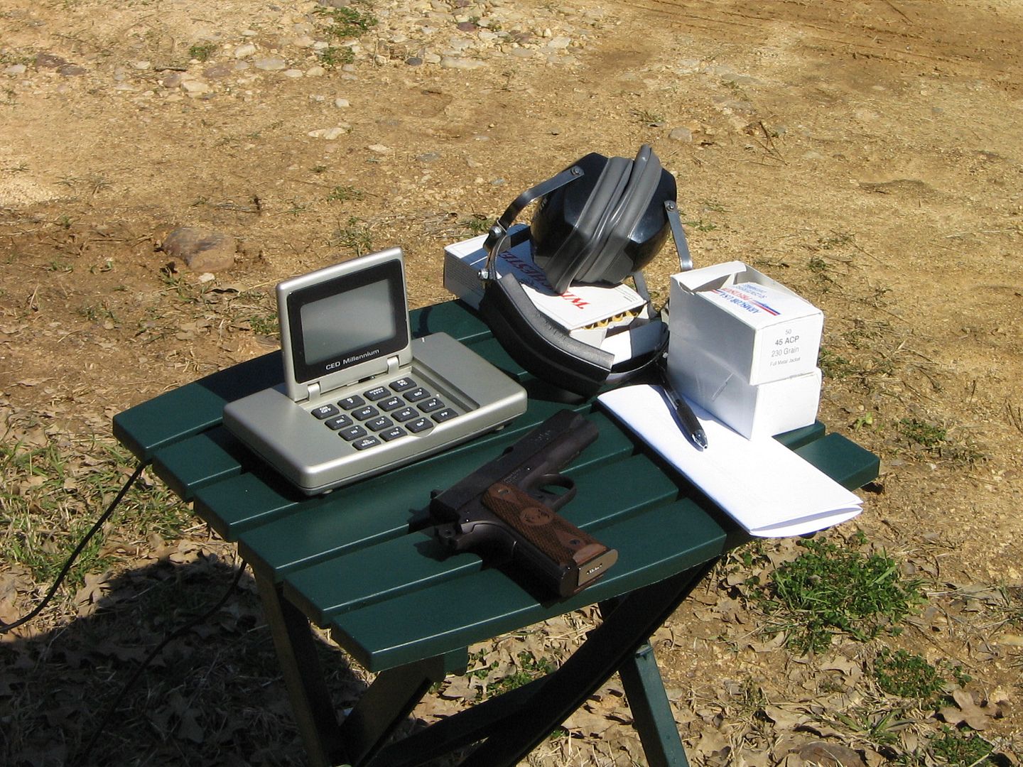

    Having finished that phase of the testing, I wiped the gun down, applied some more Gunbutter, and set up my Competitive Edge Dynamics Millennium Chronograph. The temperature was 62 degrees Fahrenheit (16.67 Celsius) under partly sunny skies. There was a 10 m.p.h wind blowing from south to north.
    Muzzle velocities were recorded using a CED Millennium chronograph set at 15 feet from the muzzle. Data recorded in English units and metric values calculated.
    Readers of my previous gun reviews will note that I moved the sensors on the chronograph back a few feet from the 10 to 12 feet I formerly used. I noticed an increase in anomalies from “hotter” defensive-type ammunition, if the screens were placed any closer than 15 feet.
    I was surprised by two of the chronograph readings, and astounded by another one. The Sellior & Bellot ammunition was more “anemic” than I remembered, while the Armscor remanufactured ammo was considerably faster than I recalled. The astounding part came with the 230 gr. Hornady TAP +P ammunition. These figures were so low that I ran a second batch through the pistol for confirmation. The second try achieved the same results.

    The Trojan also sports some of the nicest stocks I’ve seen on a gun in this price range.

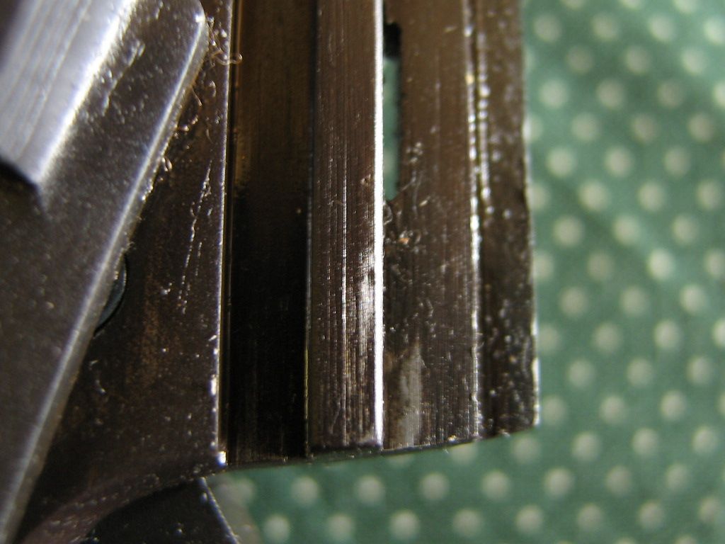

    The Trojan is tightly fit, with no discernable play between the slide and frame. Perhaps, the pistol is a little too tight?

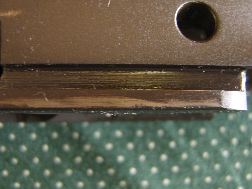

    These two photographs show the wear marks on the frame, at the back portion of the rails, below the ejector, and on the left front portion of the frame rail.

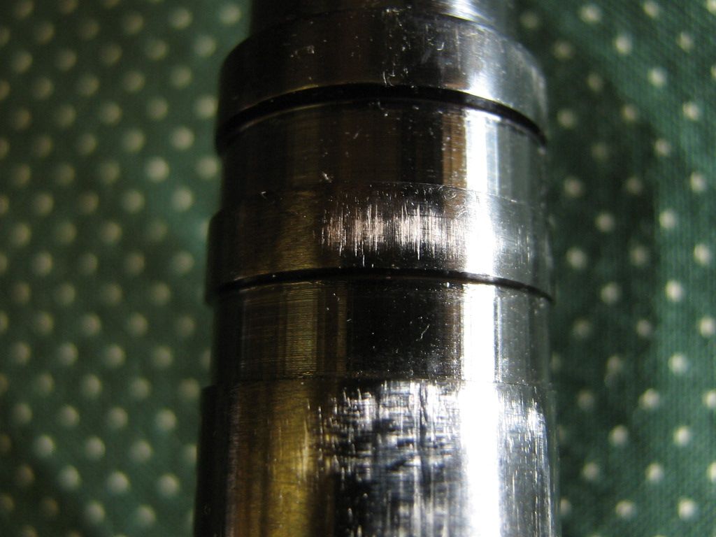

    This photograph shows the scraping wear marks on the rear lug of the barrel, as well as some scrape marks on the barrel hood.
    The numerous FTRB malfunctions I experienced during the initial 400 or so rounds fired are, in my mind, a result of slide-to-frame tolerance issues. There might also be a problem in the relationship between the barrel lugs and the slide. The “drag” marks illustrated in my photographs might indicate to Iver Johnson Arms the need to double check these tolerances with Sporting Arms Manufacturing. The problems diminished, somewhat, in the last 100 rounds fired, but the wear on the barrel lug still concerns me. Since no mention was made in the Iver Johnson Arms owner’s manual of a break-in period, I must conclude that none is normally required.
