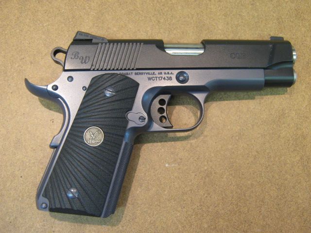

    From the Armor-Tuff black colored slide and gray colored frame finish, the machine checkering and serrations, the slight bob tail, or in Wilson Combat terms ‘Round Butt’, High Power style cut on the slide’s fore end, undercut trigger guard, to the fine fit and finish we’ve all come to know about Wilson pistols, this one has it all and you will not be disappointed!
    Wilson’s own rear sight, and monogram;
    Slight bevel to the bottom edge of the slide;
    Tight slide to frame fit, and smooth back of slide;
    High-Power treatment to the fore-end of the slide;
    Cone style bull barrel, no bushing here. Also note the slight bevel of the edges, for smooth carry;
    Front sight blended into the slide;
    Top of slide serrations;
    Under cut of trigger guard, extended magazine release, and shelf style slide stop;
    Machine cut front strap checkering;
    Magazine well bevel;
    Slight bobtail;

    I put 700+ rounds through the pistol during 3 different shooting sessions. Besides using the 2 magazines supplied with the gun, a #47OX 7 rd and #47DOX 8 rd which of course are Wilson made, I also used some stock Colt, Metalform 7- & 10-rounders, Metalform 7-rounders with the Wolff spring update, Metalform magazine bodies with Wilson’s 8 round conversions, and some unknown make of magazines that have given other guns problems, along with 10 different types of rounds.
    All 3 sessions were shot from CQB contact distance, as well as 3, 5, 7, 10, 15 and out to 20 yards. This pistol has one of the sweetest recoil actions I have ever felt in a short-barreled 45. As noted above it has the original design small radius firing pin stop, 20 lb recoil & 19 lb main springs, but this gun recoils straight, level and extremely easy ... meaning there’s no felt sharpness to it. Even when I put +P ammunition through it, there was no felt torque in the hand, it stayed straight and true.
    I ran a good mixture of ammo through the pistol, most of which is currently available on the market today. A few are not so available anymore, but I wanted to see how well the gun functioned with some of the more problem feeders of our day, most notably Speer’s old tried and true 200gr Lawman aka “The Flying Ashtray”, and Cor-Bon’s 185gr flat point HP. I put 50 rounds of each through the pistol, and ‘nary a hesitation.
    The other ammunition run through it was; Remington’s Golden Saber, Federals Tactical L.E. and HST, American Eagle ball, as well as their Hydra-Shok. Speer’s Gold Dot, Winchesters SXT, and good old Winchester’s white box ball ammo, or FMJ.
    Through the 700+ mixture of rounds above, I never had one malfunction, or even a hesitation.
