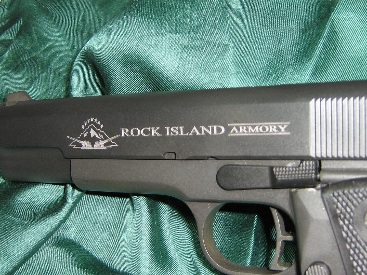

    The pistol comes with a Parkerized finish and, as I’ve noticed with past Rock Island pistols, the frame and slide are ever-so-slightly of different shades. The photo also shows the roll mark on the left side of the slide.

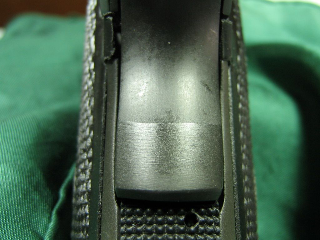

    The beavertail grip safety utilizes a “speed bump” to positively disengage the safety when the pistol is gripped.

    One other point of possible contention is the whitened roll mark on the left side of the slide. I have read on the M1911.ORG Forum of complaints about this rather garish treatment of the slide. While I don't personally like the change, it is merely cosmetic and has no bearing on the function of the gun.
