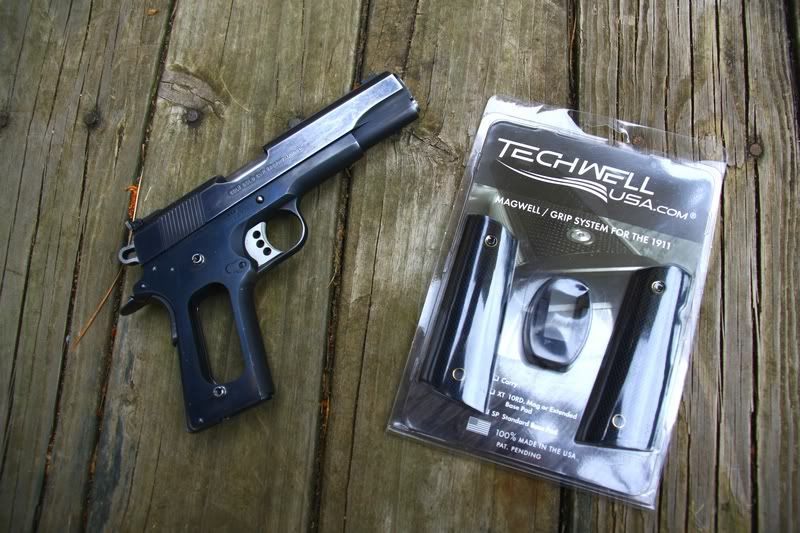

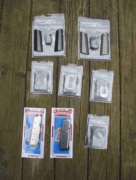

    What came in the mail for the review.

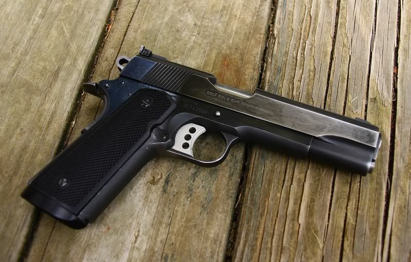

    What I started with.

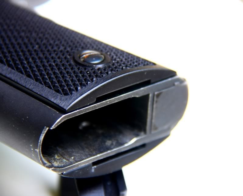

    By adding a funnel (for lack of a better term) to the magazine well of the receiver of your pistol, you increase the target area for the fresh magazine. I have spent a lot of time practicing magazine changes and I have become fairly competent in finding the narrow magazine opening of my pistol frame, but not every time is a textbook mag change (actually, more times than not it is not textbook form). By adding a funnel (aka magwell) to the magazine opening and increasing the target area, you increase your chances for the fresh magazine to find mark.
    There are plenty of aftermarket magazine well options, but the open questions are: How well do they work, and how easily are they installed?

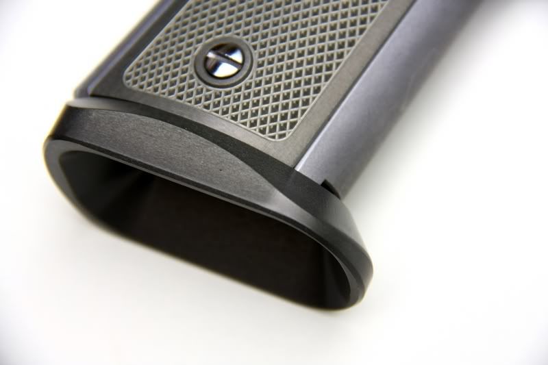

    Many folks shoot matches with the same pistol they carry. A large magazine well is ideal for competition; however, it is less than ideal for the times you are using your pistol for concealed carry. Well, Bob Novak, an accomplished competitive shooter, put some thought into this as far as the Government Model is concerned and came up with something so simple it will make you ask yourself, “Why didn’t I think of that?” The TechwellUSA System is available in three interchangeable sizes, and it installs as quickly as you can turn the four stock screws.

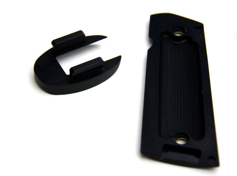

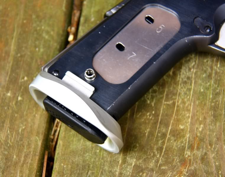

    The TechWell USA System is held in place by the stocks, which have a void machined in the inside bottom to accept the lugs of the TechWell.
    When the stocks are installed, the lugs of the extended magazine well fill the void and the extended magazine well is held securely.
    Once you snug down the stock screws, the extended magazine well is well secured and I could find no vertical or horizontal play.

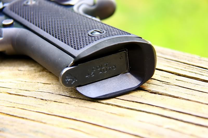

    One could easily drive to a match with one's pistol concealed using the “Carry” model and, upon arriving, swap to one of the two competition models for the match (SP for Standard base Pad, or XT for “XTended" base pad on magazine—see explanation below), and back again before leaving the range. Each of these swaps would take about two minutes.

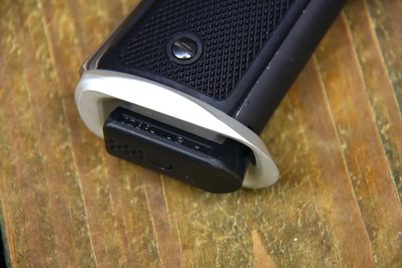

    A Colt Government Model with the XT
    One drawback to any magazine well extension is that it adds length to the bottom of the magazine well. With standard magazines fitting flush to the receiver without the magazine well extension, they would be recessed in the extended magazine well. This would make reliable seating difficult.
    Now, as many of us have seen, many magazines come with base pads. These base pads (or “slam pads,” as I have heard them called) add the length necessary for reliable magazine seating.

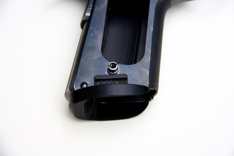

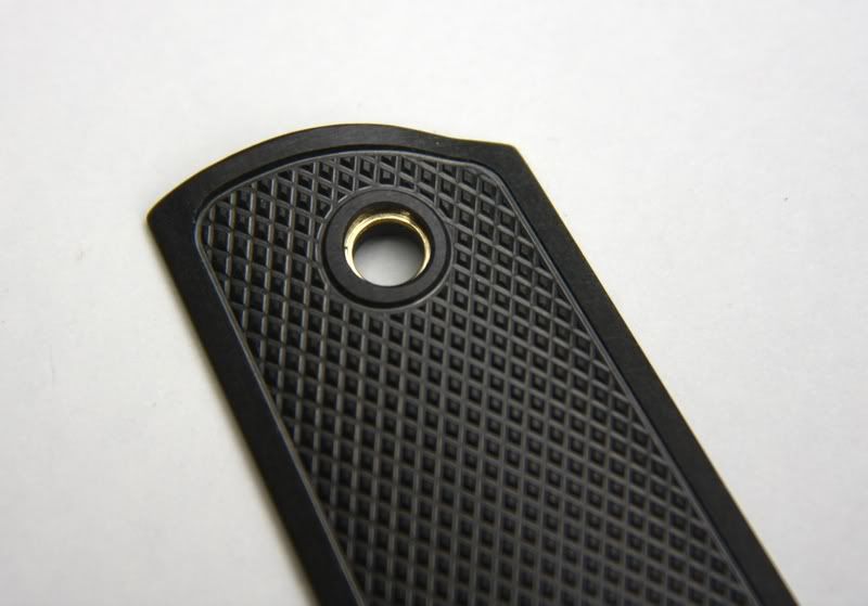

    The Alumigrips have a brass insert for the stock screw.
    The right stock is cut for an ambidextrous safety
    The bottom of the receiver with the stocks installed.
