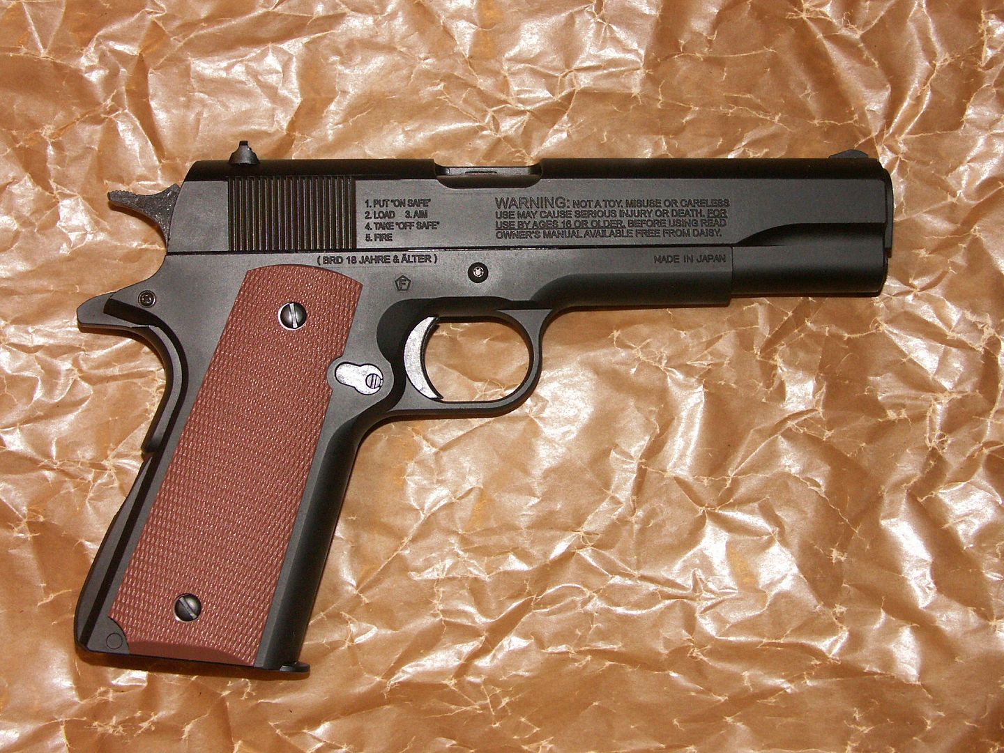

    The Winchester Air Pistol Model 11 pistol is a rather good rendition of a Government (full) size 1911, albeit with some differences due to its being an air gun rather than a true firearm. It is nicely executed, with a matte black finish that is uniform all over and exhibited no runs, sags, or “holidays” (as the painting trade refers to uncoated spots). At first glance it has all the usual 1911 controls in the correct places. The overall heft felt close to that of a real 1911 pistol, weighing in at a very realistic 32 ounces. Overall, we were not disappointed with anything about the first impression.

    Unlike any “real” 1911 I have ever seen, the controls on the Winchester Air Pistol Model 11 are clearly labeled for their functions. The slide stop is marked “Slide Release” and the magazine release is marked (ahem) “Clip Release.” The thumb safety is functional, and is not labeled as a safety. However, when in the FIRE position a red dot is exposed on the flat of the receiver, next to which is a letter ‘F’ for “Fire.” Unlike real 1911s, the thumb safety can be applied whether or not the hammer is cocked.
    The slide stop and magazine release, showing the markings for purpose/function
    The thumb safety. Note the red dot above, to indicate the "Fire" position, and the safety lock button
    The grip safety articulates normally, but serves no function. The trigger can be pulled and the pistol will fire without depressing the grip safety. Thus, while the Winchester Model 11 gives every appearance of being true to its 1911 inspiration, the manual of arms is slightly different.
    This extends to the operation of the thumb safety, as well. Aside from the fact that it can be applied when the hammer is not cocked, when the thumb safety is applied a small button pops out just beneath the paddle. The safety cannot be disengaged without first depressing this button. This means that, if this pistol were to be used for practical/tactical exercises, it would NOT be possible to draw the pistol from a holster and sweep the safety to the off position one-handed while raising the pistol to acquire a target. Given that a BB-gun must be regarded primarily as a child’s or youth’s toy, this is understandable. I have no doubt that the legal department would prefer to make the gun safer at the expense of “authenticity” rather than slavishly adhere to the 1911 manual of arms and risk injuries to young shooters.
    The pistol is stated to function by blowback, and the slide does function during shooting. We couldn’t tell if this is just for effect, or if the slide’s retraction and return to battery is actually necessary to load the next BB.
    The first time we had to lower ourselves to reading the instructions was to install a gas cartridge. The Winchester Air Pistol Model 11 uses standard 12-gram, disposable CO2 cartridges. We had several boxes of those on hand. What we couldn’t figure out was where and how to install them. The procedure is simple enough, but it required knowing what to do before attempting it.
    In fact, since there is no mainspring, the mainspring housing is essentially unnecessary on this pistol. So those diabolically clever engineers used it as a lever to control the loading of the gas cartridges. The mainspring housing is pivoted out from the bottom and then a lever is pulled away from the receiver. The left side grip panel is removed and a cartridge is inserted. Then the mainspring housing is rotated back into the closed position to force the gas cartridge up, pierce the seal at the tip, and seal it into position. It probably takes longer to describe the process than it does to perform it – once you know how to do it.
