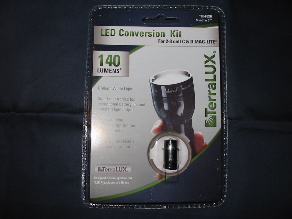

    A few days later, the big brown truck brought me a care package, and I immediately set out to test the new LED modules. The modules specific to Mag-Lites are rated at 3 watts and 140 lumens, and there are different models depending on how many batteries your Mag-Llite uses. Mine are all 2-cell and 3-cell, and the same module fits both. There is a different LED module for upgrading 4-cell and 5-cell Maglites. There is also a 1-watt, 50 lumen "universal" module that TerraLUX says will replace the original bulb in any flashlight from 2 to 9 volts and using from 2 to 9 batteries.
    The new modules come securely ensconced in a blister pack:
